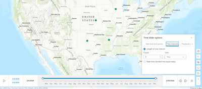

If you create a time-ware Web Map - I've been encountering that if I set the timebar to "show features progressively" and the save the map and make it public, it will automatically revert back to time intervals instead of progressive. This shows up with both Chrome and Microsoft Edge.
I've managed to reproduce it with feature layers that I just created as well as data that I already had in the system that worked previously.

Hi Sara, Thanks for reporting. This does look like a bug and we are investigating. In the mean time, if you choose Play from position saved with the map as the Playback position, it should save the progressive mode.

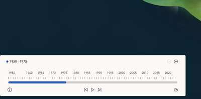

When I open the web map the time slider is full.

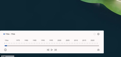

But when I open the dashboard it only show the first year.
If I use the custom time settings in the widget it will display however much is set for the length of one step. In this example 25 years.
It will not show the whole timeframe no matter what I have the settings set to.

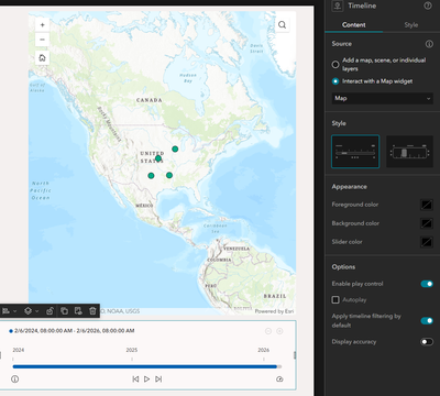

@AJM, do you have the web map and ExB app that we can investigate? This seems to be related to the configuration or data, and I cannot reproduce the issue using my own layer:
MV
In ExB - either map widget or web map as data source show the same time extent as your settings
Also, you said "when opening the dashboard", what does this dashboard refer to?
