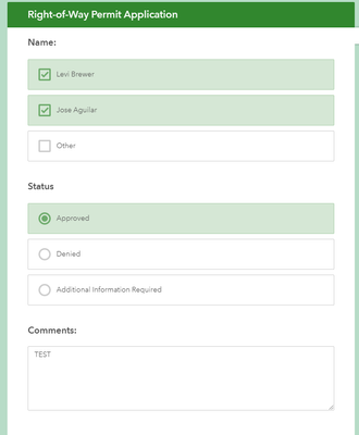

Hello everyone,
I have created a dashboard for our ROW Permit Applications. On the back end, I created a survey so that our Water and Wastewater supervisors can review them and either Approve or Deny them.
I am wanting to write an expression that will only change the status (symbology) to Approved when both supervisors have submitted the survey as approved. Is this possible?
Any guidance would be greatly appreciated as I am not even sure where to start.
-Cody
