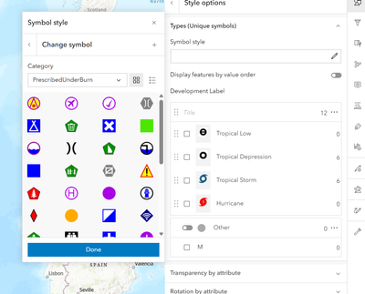

Community I'm having inconsistency using ArcPro styles that I've made/shared to AGOL in a WebMap.
The style shares fine from Pro to AGOL and the Line and Poly component of the style file works fine.
It's when I try and add the style in the WebMap for Points that the style does not show up in the style search.
I have successfully shared and used more simplified point styles in a WebMap, leading me to believe my process is correct.
Prior to building out the style file again (48 custom symbols) and getting the same result, I'm asking the community;
Is there guidance to be found on the specific constrains for WebMap point styles?
Am I asking to much of WebMap?
These are all simple symbols 2D with no more than three layers in them using common RGB.
Most of these already exists and are used in the wildfire industry AGOL world, I'm just trying to change some colors and a few layers.

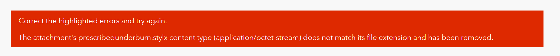

Lastly it looks like I can't attach the stylx file.

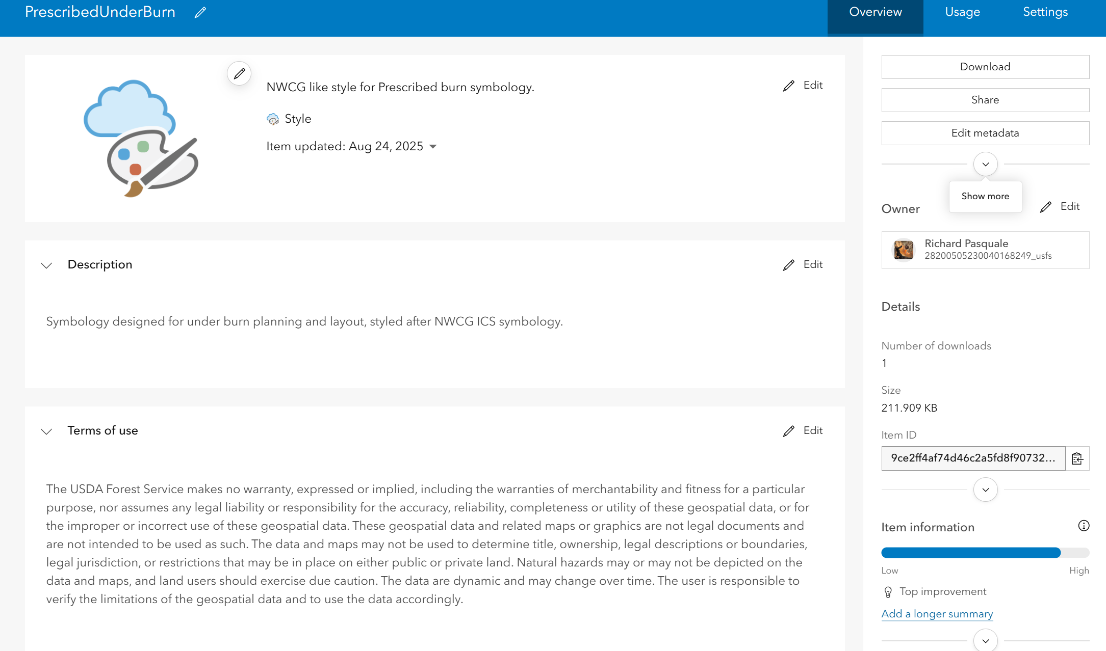

https://usfs.maps.arcgis.com/home/item.html?id=9ce2ff4af74d46c2a5fd8f9073280937

Can you share the web style and desktop style into a group(invite russell_jsapi) or publicly.  If the style has already been added into a custom group to drive the web style gallery or the adhoc add it directly in map viewer for lines or polygons then the style does not need to be added again for points.

The style looks fine to me with the one shared to the group. It has the correct typeKeywords for point lines and polygons.
This is how I added in
