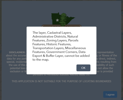

Here is one of the WAB applications that are having issues:
https://hubbardcounty.maps.arcgis.com/apps/webappviewer/index.html?id=405588666bba4397982b98b3fd382f...
Here's the underlying web map:
https://hubbardcounty.maps.arcgis.com/home/item.html?id=418bec418d7f475fb6957d53bc4fa468
Note that if you open it in the new Map Viewer, it works just fine.  Only Classic seems to be having issues.  Unfortunately, several of our older WAB applications do not play nice with the new Map Viewer, so we've been forced to use Classic.
Below is a screenshot of the errors we're getting when using Chrome of that build.  Any of the County hosted layers are not working at all.
Also note that this is only impacted by Chrome Browsers on that particular build.  Firefox and Edge appear to not have any issues currently.  The previous Chrome build (v. x.59) also had no issues.  I've not been able to fully test off network yet to see if it is an internal only issue.

I am not seeing this issue on the latest version of chrome using the web map and WAB app you provided.  That error above makes it look like the services are either timing out or no longer accessible while the app is loading. If you are able to look at network or console logs while loading these maps and apps and catch any errors can help us see what the issue could be. I'll keep spot checking to see if I get any loading errors still.

Looking at the Chrome console when trying to load up that particular WAB, this is the first of many errors that occurred:
All the errors appear to be due to "blocked by CORS Policy".
