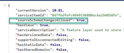

At the Rest endpoint for the parent layer, you can see the sourceSchemaChangesAllowed property. This will confirm if the service is not allowing schema changes. To see this, select the View option next to the service URL at the bottom of the Item Details overview page. This opens the Rest endpoint in html format. Add f=pjson&  to the URL so that it looks like .../FeatureServer?f=pjson&token=agfykD... then press enter. Look for the following property - for your service I would expect it to be false.

AshleyHayes2
Hi @Anonymous User ,  Thank you for the reply!  That property is actually showing "true" for my service.  I don't mind deleting and re-creating my views once if that is my only option, but I would like to try to get a better understanding of what may be happening in case it happens again.  Any further suggestions?  Thanks again, Ashley
by Anonymous User
Not applicable
Hi Ashley, that's interesting - not what I expected. Deleting and recreating the views may still be a good troubleshooting step, but it doesn't seem like the issue is caused by this property.
