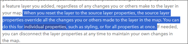

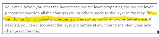

AGOL documentation  page entitled "Set layer properties" says that you can save individual properties or all properties at once, but doesn't specify how to do either.

AGOL documentation  page entitled "Set layer properties" says that you can save individual properties or ALL properties at once, but doesn't specify how you would do one vs the other.

By default, any changes you make to the properties of feature layers in your map are stored in the map when you save it. Saving to the layer saves all the properties you have configured in that map (forms, pop-ups, symbology, etc) so that you can easily use them in other maps.

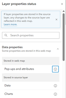

I think what's throwing you off is this section Doc on Save Properties 1.png
which refers to the properties you can manage here:

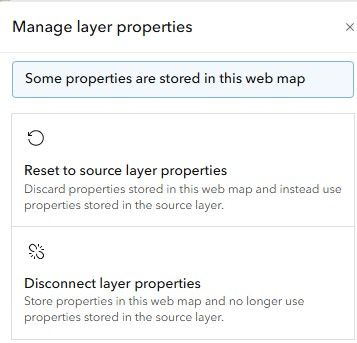

I hate to belabor the point, but if I click on the Manage Layer Properties button that you highlighted, it presents 2 options:
 I can either reset ALL properties to the source layer OR disconnect from the source layer and have ALL properties saved in the map.    There does not appear to be a way to save an individual property to the source layer vs the map as indicated in the 2nd sentence that you highlighted from the documentation.

Yep, I see your point. You're not presented with a menu that lets you choose what individual thing to save and where. You can save individual things differently than others (layer vs map), and you can view and manage those in the way that you described.
If you’d like to see a menu to choose what to save where, you could submit an idea or enhancement request.
If what you want to do is save a form on the layer, but not save the pop-up to the layer, you can do that by taking these steps in the following order:
  • Create the form.
  • Save the layer.
  • Create the pop-up.
  • Don't save the layer.
Hope that helps!
