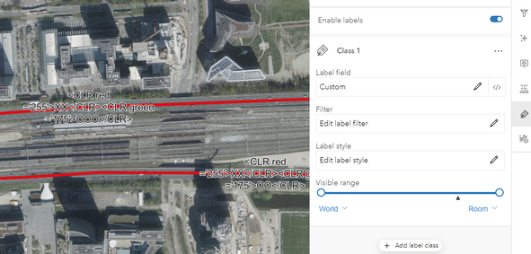

Hi @XanderBakker  The rotation of labels is simple in ArcGIS Pro and even with Arcade the appearance can be manipulated but all this effort is useless after publishing to AGOL you left with plain labels.
Publishing to a tile layer is not an option because the dataset contains multiple records. And after publishing to AGOL the hosted feature layer is used in a joined view to visualize a projectplanning with time slider.
In ArcGIS Pro 2.8.3

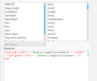

I show highways and which lanes are closed. With an arcade expression I can give the label multiple colors related to an attribute. And the position of the label is perpendicular repeated  and aligned based on the direction of the polyline. I this situation it is important that the polylines have the same direction of the traffic flow.
In ArcGIS Online
Classic Viewer

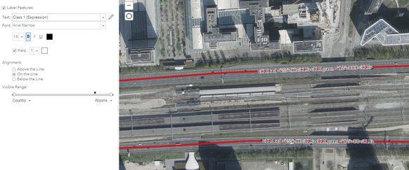

- the arcade expression in not accepted. So why Arcade in ArcGIS pro is different from AGOL?
- in classic viewer the label can be aligned but very basic: Above, On or Below the polyline
Map Viewer
-  labels can cannot be aligned anymore?

  • Unfortunately, there are differences in Arcade versions as you can find in the version matrix: https://developers.arcgis.com/arcade/guide/version-matrix/ . In this case, it is not the version difference, but the fact that the labels in a web map currently do not support these HTML-like capabilities that allow you to change the font of parts of the label. Next week there will be an update and many changes are coming to the map viewer (not the Map Viewer Classic). There are some changes that allow you to edit HTML for the pop-up, but I do not know if this changes something for the font settings that you are using in Pro.
  • in the Map viewer labels can be aligned already. You will find the placement options when you edit the style:
  • Not sure if the new version will have label rotation.

 But unfortunately, the placement option to align the label is not available when I open Edit Style.
(I am working in a Project Delivery Site and tested in Chrome or Edge)
