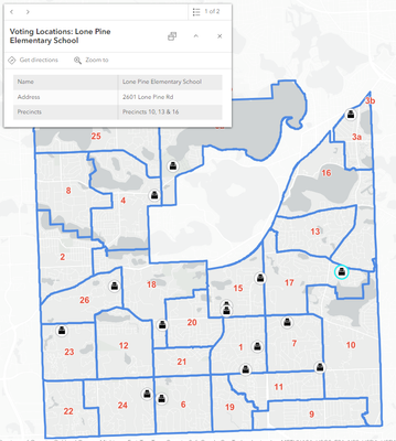

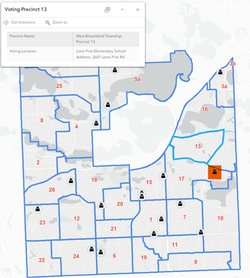

Thank you so much, John! It worked like a charm! Now I'm able to select the precinct and the pop up will show the voting location.
I'm still trying to figure out how I'd go about having the voting location feature get selected once the user queries a precinct, for example. As it shows in the first screenshot, when I select the precinct, it'll give me the address and location name - which is already great. However, since for that precinct the location is actually not within the precincts boundaries, I have to manually select the voting place.
I'm wondering if there's any tweaking around a quick app to make this happen, or if I'll just have to use Experience Builder to trigger this kind of action. Any suggestions?
Again, thank you so much for your help! 🙂
JohnEvans6
There's not really a lot of options via arcade for that. If you enable search on your polling place you could use the find parameter to add a URL to the summary window, but that basically opens the same map at the same place in a new tab with the polling place selected, which feels redundant. If its a good enough work around, just append
&find=856
or whatever the polling place precinct number is.
