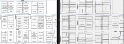

What is going on with the polygon labels?  Something has changed recently.  I have several polygon with the same shape, but different labels.  For years, if I tried to label multiple layers, only the top label would draw.  AGOL doesn't have different labeling positions within the polygon.
I just had a user tell me now they are all labeling right on top of each other!  Attention ESRI web map developers, what is going on here?  What has changed and how do we fix it??!!

Hi, I could share a similar map.  I do not want to off set labels, because then, they are always offset regardless of if that is needed to "fit" more labels.  The way the software previously behaved, is if there are multiple layers with identical features, only the top most label would draw.
please see this map:   https://experience.arcgis.com/experience/c86b811e922848d58ef2cfd110acf0b9
Under the OWNERSHIP group, zoom in until the parcel turn on, then turn on quick ref labels, party name labels, and leave parcels on with the default labels.  They all overlap.  These are all "views" of the same dataset, just created for labeling purposes.  Sometimes users want different labeling options depending on how they are using the map.  This NEVER happened before.  It was working fine as soon as last week, then had a user report an issue and I've noticed it's on all my maps.

We are looking into improving this behavior for the upcoming release. As a workaround could you use a group layer with exclusive visibility and then the viewers of the map would toggle through those overlapping layers to see the layer and label that matches them.
ClintOffutt
Hi, I am glad to know you are working improving that behavior.  I also appreicate your suggestion on the group layer and might have to go that route until things improve.  I just think it gets too complicated in this instance as those layers already reside within a group and most users of my maps are not wanting to dive into mulitple groupings.  I just think the thing that is so strange is that these maps (I have 9 of them) never used to do this until very recently.

This was a change from a deconfliction strategy project. We are working on exposing a static and none deconfliction mode within the labeling experience and detecting label deconfliction between duplicated/repeated layers.
We are working on automatic placement for polygons so if you zoom into one quadrant of the polygon where the center is not visible the label will dynamically fit into.  Other placement options are on the roadmap but this previous one mentioned is one we are hoping to get into this upcoming release as well.
