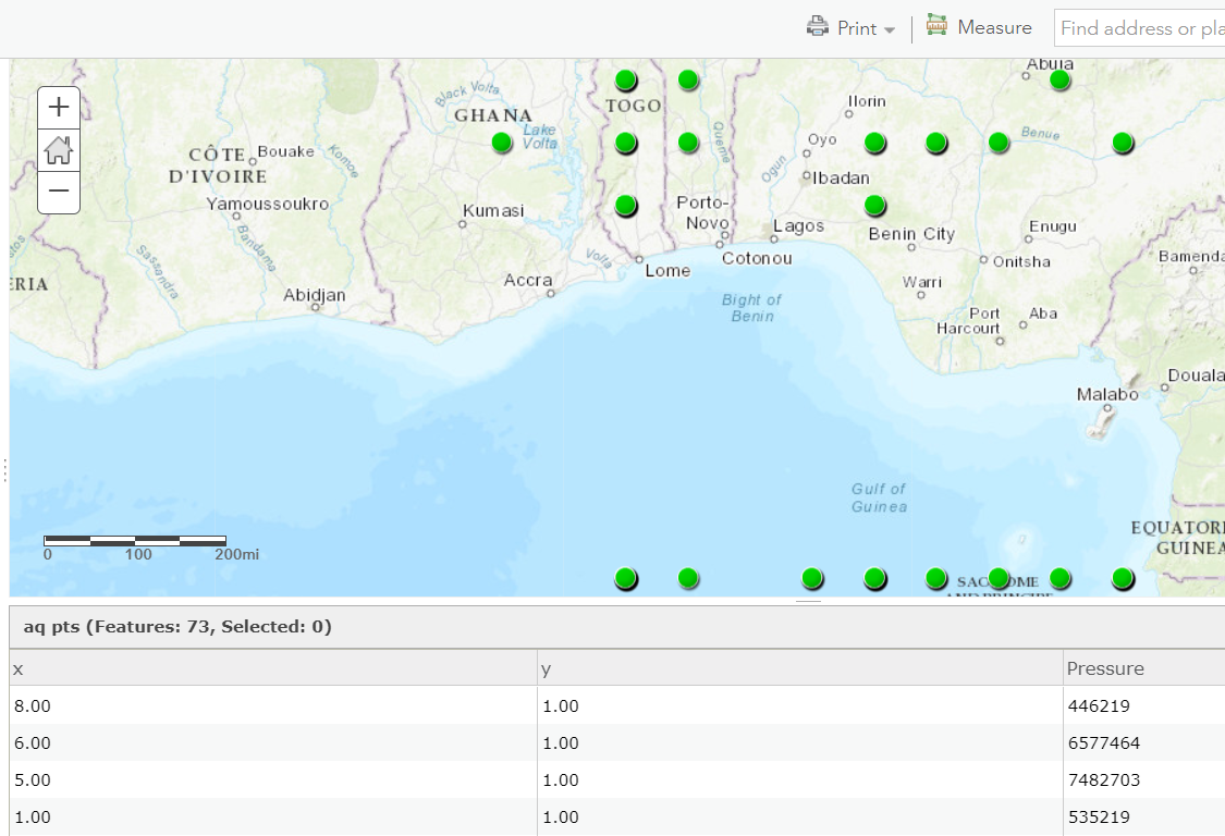

I think you're on to something with the commas and the language barrier. However, this is what pulled up for me:
It took the value of 8650614739 and turned it into 8.00, and so on.
What values are your X and Y columns supposed to be in? AGOL expects CSV files to be in proper latitude and longitude in order for them to be read properly.

I was able to get the file uploaded correctly using .xlsx! Now I am now getting the same coordinates as you instead of the coordinates from Texas I'd like to see.

Yes, changing the coordinate system is a desktop thing. Do you have access to the desktop software? This is where you would display the data in the State Plane system like you mentioned. After doing so, you could export your data to the WGS 84 system to get lat/long coordinates, or just export to a shapefile with an appropriate projection and AGOL will read it just fine.
