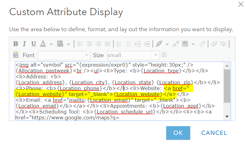

 And here is where I put the expression (I replace the highlighted text with {expression/expr0}

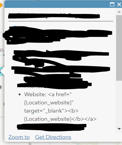

And here is the pop-up (forgive my messy redaction work):

I notice that you are trying to return HTML from the Arcade expression. This does not work in ArcGIS Online (it does in Pro). When you return HTML from an Arcade expression it will interpret it as plain text and not as HTML.
What you need to do is use a different approach. Have a look at this post: https://community.esri.com/t5/arcgis-online-documents/conditional-field-display-with-arcade-in-pop-u... Here you will see that you can conditionally display part of your content.
So, your HTML should include both cases (link available and link not available), but depending on the situation you will hide or show each part. This will multiple expressions, but it is not very complex to achieve this.
