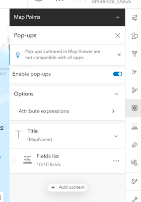

Hello
I need assistance with configuring pop-ups to show different images for one layer in each specific points. My layer has 240 points, and I would like to add pictures that are associated with each point. I would be grateful for a response with some guidance, because I have been struggling.
Thank you
DanielMiranda2

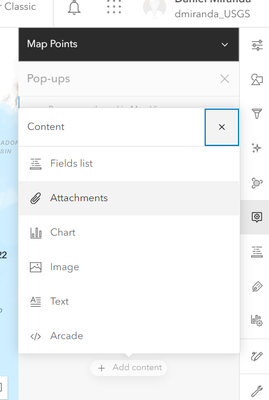

Do you already have images attached to your point layer? If so, you can configure the popup to show it. In Map Viewer, open your layer's properties and then click on configure popup. Then click Add content, then you can add attachments. Once saved, the popup will show the attachment associated with that point.
