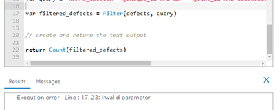

Hi Johannes, sorry another question. I've been asked to try nd symbolise the road inventory but the defect count number, so I thought about trying to run the above script in a new field and using the field calculation option, taking away the Push function element of the above code but it doesn't like it at all.
I get an error message at line 17 which falls on the var filtered_defects = Filter(defects, query)
I've tried this:
// load the Defects layer
var defects = FeatureSetByName($datastore, "Defects", ["*"], false)
// filter the defects by UniqueID, LaneID, and Meterage
var unique_id = $feature.sect_label
var lane_id = $feature.xsp_code
var start = $feature.s_chainage
var end = $feature.e_chainage
var query = "UniqueID = @unique_id AND Lane = @lane_id AND Meterage >= @start AND Meterage <= @end"
// create and return the text output
var return_lines = [
Count(filtered_defects)
return return_lines

cat206
I did try that but get the same error message on line 17. Not sure what the issue is but i'll keep trying
