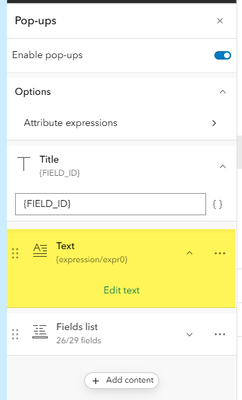

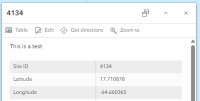

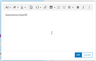

I'm referring to a text element like this:
The expression used in that element just has a text return, not an object return
var label = "This is a test"
return label
