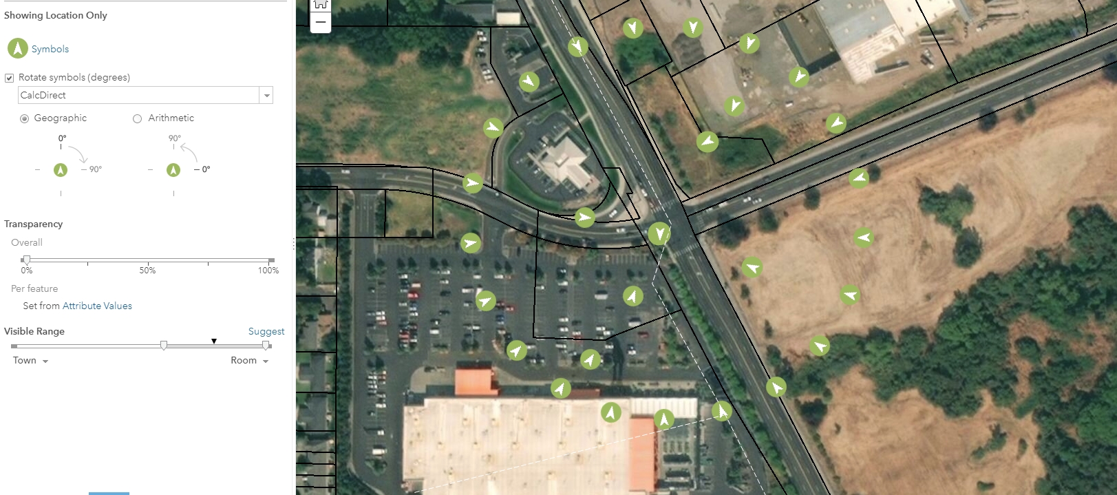

I'm not publishing an entire map/MXD, but here's a screenshot of a hosted feature label with rotated symbols based on attributes in AGOL.
(Zipped SHP uploaded and published, changing symbol in AGOL)
