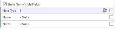

I actually heard about this today. The short of it is that I think it's stored in the Template, not the actual feature class.
So, apparently, to do this, you open up the template in Pro and go to the attributes page.
Each attribute should be blue on the left side.

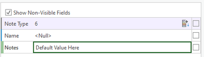

Change the default value(s).
The attributes should turn green or grey
Green or grey will work when you upload it, but blue won't.
*Full disclosure I got this secondhand and have not tried it myself, but it's at least something to consider.
