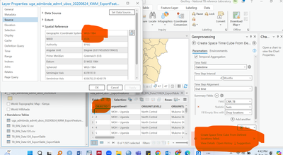

Am doing emerging hot spots but i keep getting this error ERROR 001022: This tool requires a projected coordinate system.

You need to project the input data before you run the tool.
