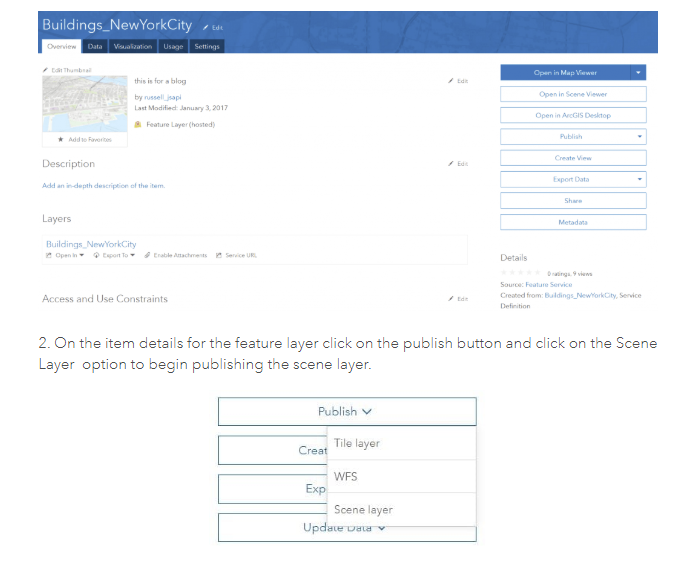

View of ArcGIS  options from the How to:

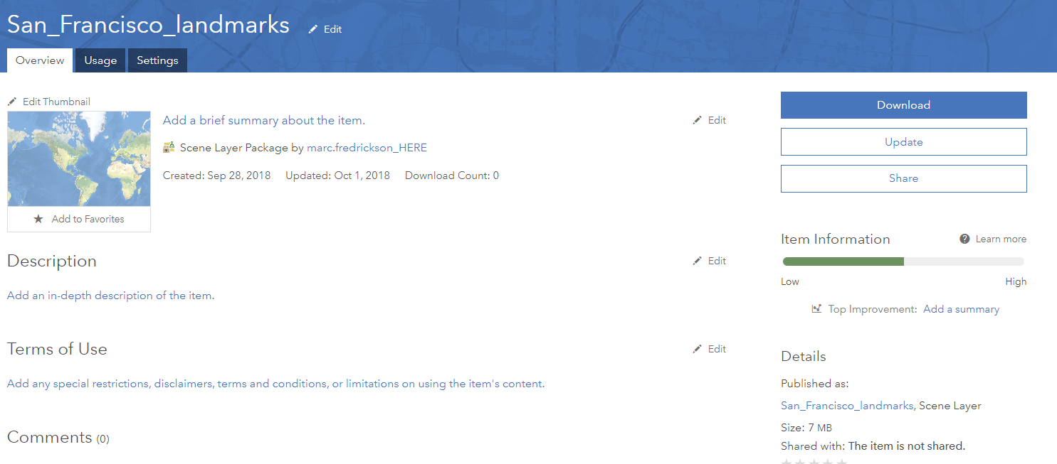

View of my ArcGIS  options:

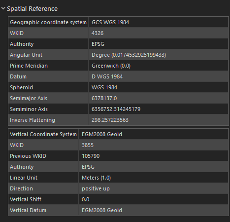

 This is the spatial reference of the .slpk as seen in ArcGIS Pro:

The first thing I'm noticing that the one in the the tutorial is a hosted feature layer and on your map it is a scene package.
These two have different capabilities and why you are seeing different options take a look at this information:

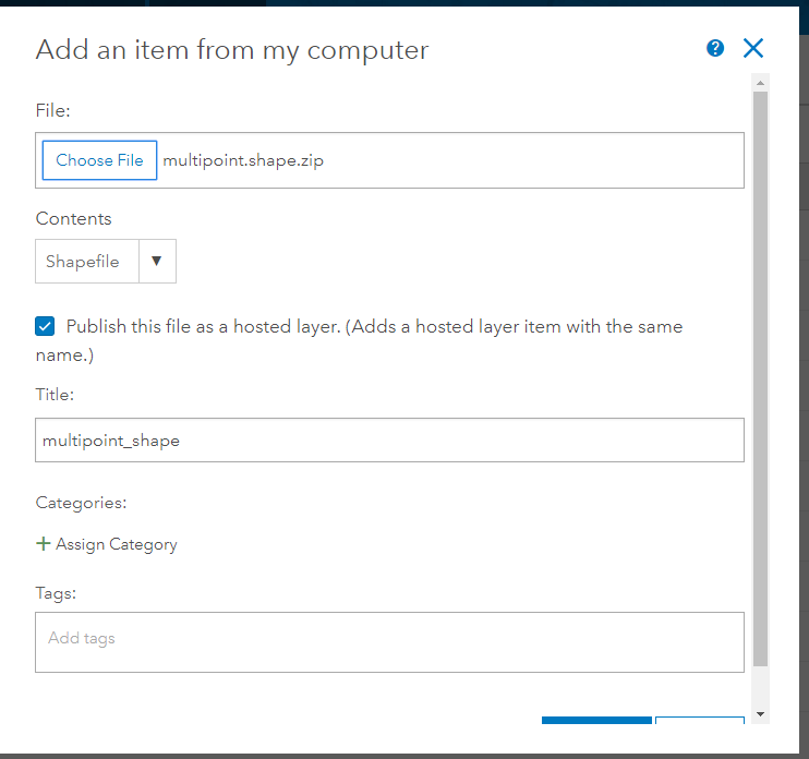

  2. Upload in ArcGIS Online a hosted feature layer:
    1. When uploading in ArcGIS Online it will have to be a zipped gdb or shapefile not the scene package
    2. Then go to Add item>Add from computer>Publish as hosted feature layer
This will publish a hosted layer. Go to the hosted layer>Publish>Scene layer
