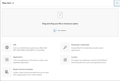

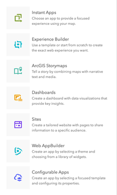

Hello all. I am trying to create a point-based Feature Layer to use for a Storymaps map tour.

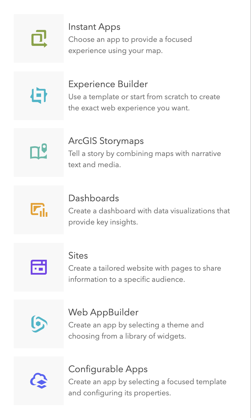

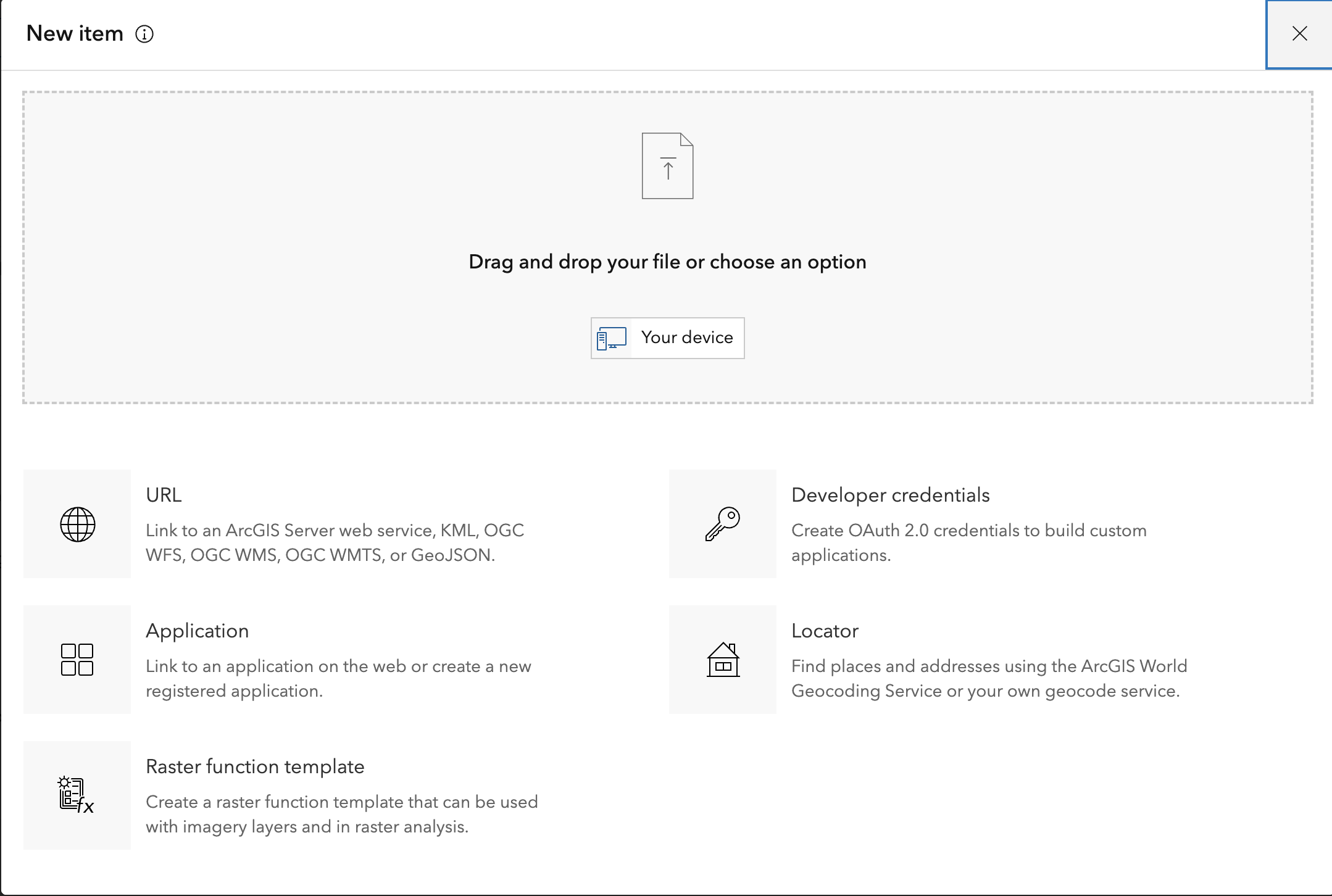

But in the Content tab of my organization’s ArcGIS Online, under “New Item” there is no option to create a feature layer. I’ve attached what I can see under the “New Item” and “Create App” menus in Content. Can anyone help me understand why I don’t see an option to create a Feature Layer in ArcGIS Online and how I can create one?

It looks like you were assigned a role that does not have the privilege to create a feature layers.
https://doc.arcgis.com/en/arcgis-online/administer/privileges-for-roles-orgs.htm
