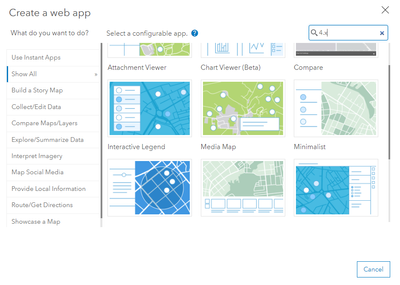

Glad to hear you are enjoying all the features we are bringing to the new map viewer.  WAB will not be getting support for these new features we are adding. Mainly because WAB is built off of the 3.X version of the JS API and the new map viewer is built off of the latest JS API version 4.x and we wont be back porting these features to the 3.x JSAPI. So to get a seamless experience with features you will need to use 4.x applications like Experience Builder,  Dashboards,  Instant Apps StoryMaps and if you search 4.x in the configurable apps you will see apps there as well that are 4.x based.

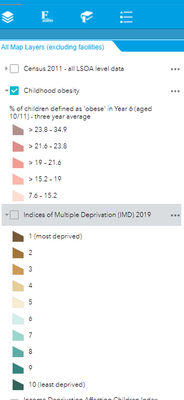

It looks as though there are some bits of functionality that I can't bring across from WAB unless I'm missing a trick?  The most important (to me) is the styling of the layers widget.  I really like the way this works in WAB, with the checkboxes, and the legend integrated into the layer panel - it makes it really easy for end-users to navigate and understand what they are seeing.  Is there any way of replicating this in Experience Builder?
