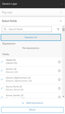

Here's how to reset the layer pop-up to the default attribute order of its schema in the Map Viewer (i.e. reverse the automatic alphabetical sort on fields in the pop-up that seems to be the default when a new layer is added to a web map):
1) In the Map Viewer (not Map Viewer Classic), select the layer of choice from the Layers Pane table of contents (left sidebar)
2) Select the Pop-ups button from the layer settings (right sidebar)
3) Select the existing Fields list button with the fields currently in alphabetical order
4) Click the Select fields button (which will change to Deselect all)
5) Click the Deselect all button (which will change back to Select all) to turn off all fields
6) Click Select all once more—notice the order reset in the "dimmed" Fields list menu that appears behind the active Select fields menu
7) Click Done at the bottom of the Select fields menu
😎 To save these changes, don't forget to click Save from the Save and open menu (left sidebar)

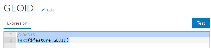

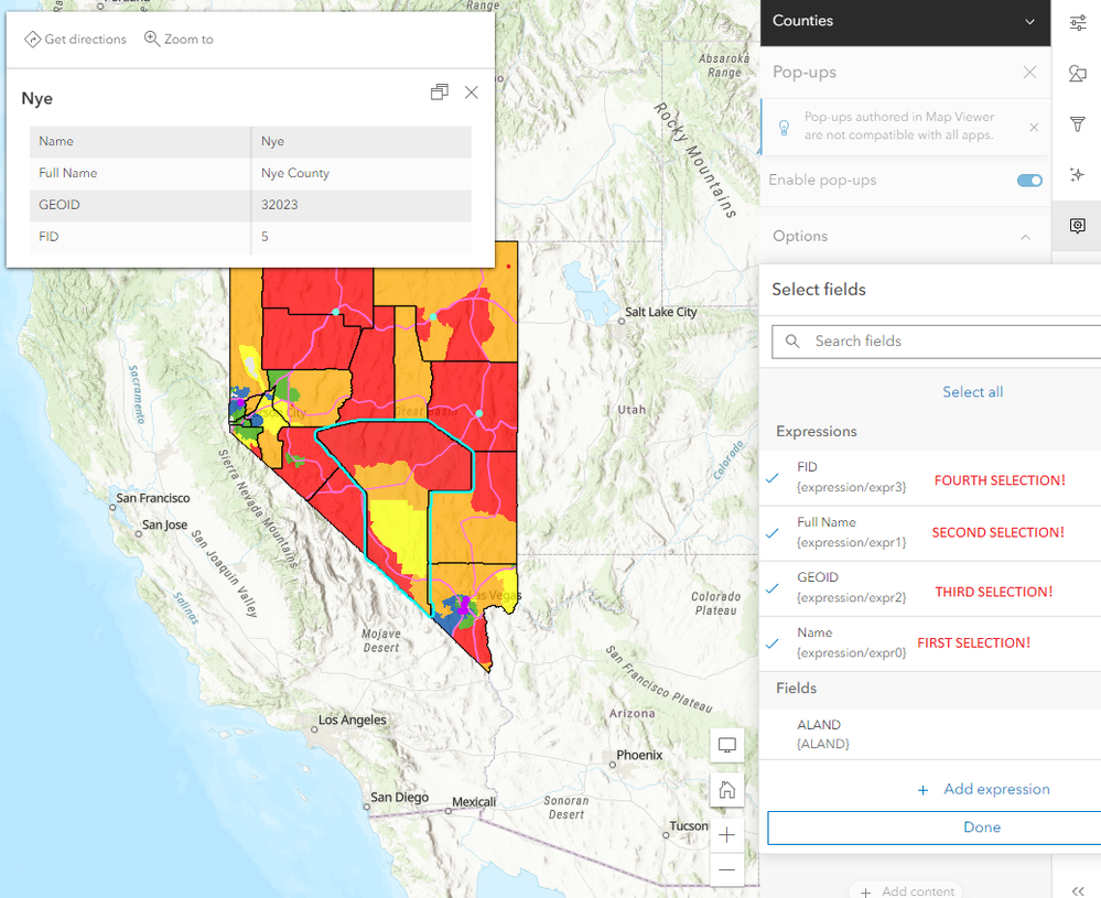

My workaround has been to convert the pop-up value type to String. Use arcade for this e.g. Text($feature.FID). I recommend creating them in the order you want them to display (this isn't confirmed to make a difference). Do this for all the values you'd like included in the pop up. Then select (add) the expression fields in the order you want them to appear (do NOT rearrange them after the selection).
Convert all values to textConvert all values to textSelect the expression values in order you want them to display (New Map Viewer)Select the expression values in order you want them to display (New Map Viewer)

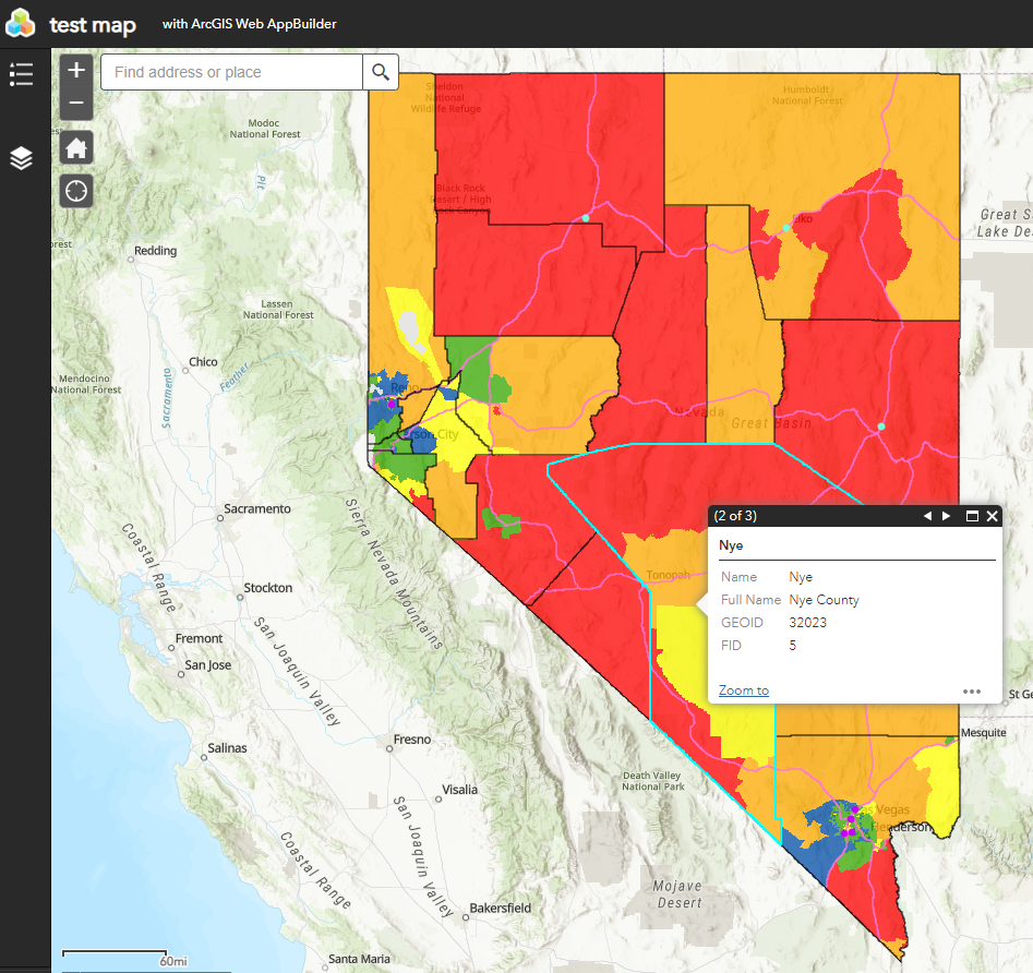

It appears in web app pop-up unalphabetizedIt appears in web app pop-up unalphabetized
