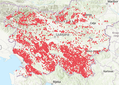

I just tried this using my public account and a CSV file with approx. 15,000 lat/long locations. Everything worked as expected.
I'd suggest scrutinizing the CSV file a bit more, perhaps there are some hidden characters at the end, etc. I can take very quick look if you email the file to [email protected]

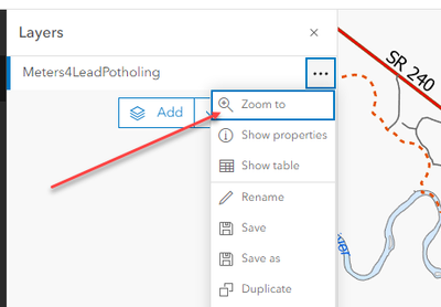

is the csv data in a different coordinate system than ESRI's web mercator?
If so, often the map will zoom somewhere in limbo and you need to zoom to the layer in the TOC.  Even if your basemap and data are the same, if it is NOT the ESRI default, it almost always zooms me to nowhereland when I add data.
