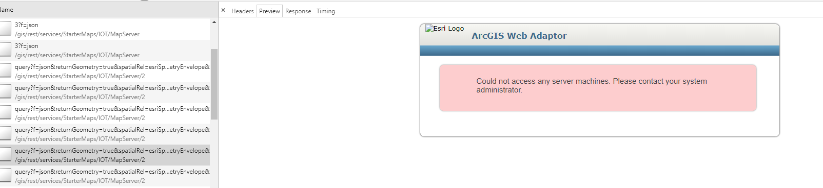

ChrisWhitmore
Brian O'keefe‌ - have there been any recent changes to the server? It appears requests are sometimes returning a web adaptor error:
