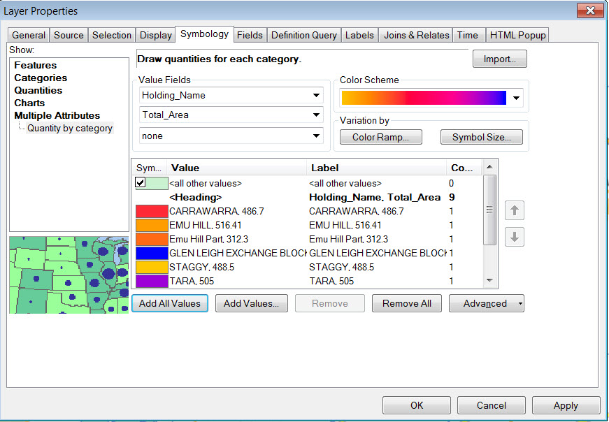

Leith_JohnHAWKINS
Deactivated User
You can  but its fairly limited !
From the Symbology Tab you cn select the Value fields you want to use!
Multiple Attributes
Leith_JohnHAWKINS
Deactivated User
Just select the Multiple Attributes option in symbology
JessicaPorter
Deactivated User
This is what my screen looks like. I don
This is what my screen looks like. Are we talking about the same program...?
