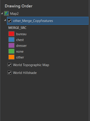

This is the entirety of the map's layers as I've isolated these features in my troubleshooting attempts:
and the map loads and renders correctly in Pro.

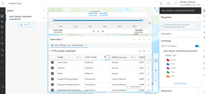

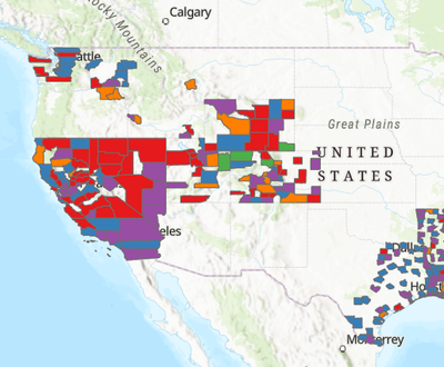

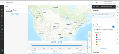

When uploading it to AGOL, I run into the following problems:
  • No polygons will display any more
  • Data is missing

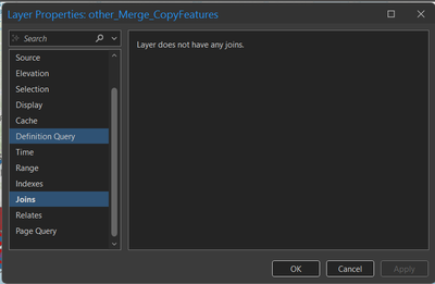

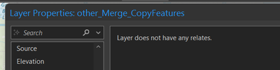

I can't figure out why. The layer has no joins or relates.

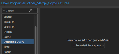

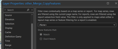

There is no page query or definition query.

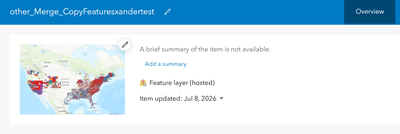

Most recently, the auto-generated thumbnail for the content actually displays everything correctly, but then refuses to open in the map.

Can you disable the time slider part of the layer? Sometimes enabling time can cause layers to display unexpectedly.

That did fix it for whatever reason. Thanks!
