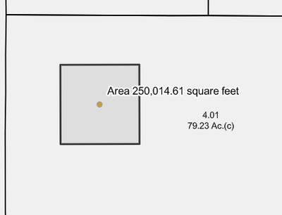

I have a web map in the my local stateplane projection.  When using the Draw widget tool tips and constraits, the "total length" (or total area if drawing polygon) does not match the label that is placed when Show area measurement is checked on.
I don't think the issue is with the basemap coordinate system, I think the issue is with the measurement widget and draw widgets.  You can't trust either!

ClintOffutt1
