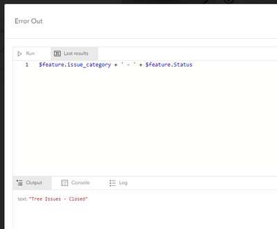

I am hoping someone might have a solution/workaround to this. I want to be able to use two (non-numeric) fields to dictate symbology in AGOL. Initially, I tried an arcade expression like the one seen in this article, however, doing this with two text fields acts like it works in the viewer, but ends up returning an error.
Method of writing an arcade expression for two fields, which does not workMethod of writing an arcade expression for two fields, which does not work

Is there another way to write an arcade expression that returns a number based on two (text field) statuses?
I have tried a When(IIf() method along with variables for each combination of category and status, which didn't work because of booleans.

This is on our roadmap to support in map viewer. Currently we will support reading in these maps styled from Pro but we dont have an authoring experience for these multifield types based renderers.
