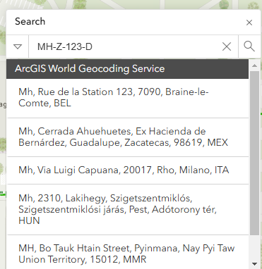

I enabled search tool for our sanitary map but only a few of the manholes with new names would show up in the search result. For example, we have a manhole named "MH-A-1" and when I type "mh-", "MH-A" shows up in the search result, but when I type "mh-a" or "MH-A", the search results only show the esri world geocoding service results, as if that manhole does not exist. I also copy and pasted the name "MH-A-1" from the attribute table to the search bar and it also only showed the geocoding service results.

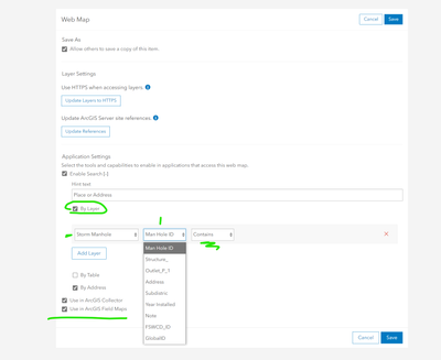

Nick_Creedon
In your webmap setting have you verified the application search settings?
You can add and update layers so they may be searchable in your webmaps.

Yes, my settings are pretty much just like yours. It only worked on the ones that was not edited but not the ones edited last Friday. The edits was made in AGOL

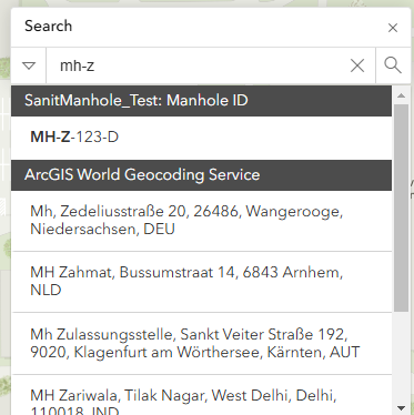

Search results from original mapSearch results from original map
Search results from test map on the reuploaded backup. I just gave that name to a random manholeSearch results from test map on the reuploaded backup. I just gave that name to a random manhole
