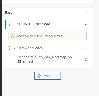

Hello,
We recently saw that Hennepin County updated their imagery service, upon trying to add to our existing Web Map that consumes these county services we ran into an issue. It appears two layers are not playing nice together, but we're unclear why since they're both in the same coordinate system as they were before and worked properly:
Basemap we're using- https://trpd.maps.arcgis.com/apps/mapviewer/index.html?webmap=5505ebdfdb3a49ea87ccbe469d1bc93f
2024 Hennepin County Service-
https://gis.hennepin.us/arcgis/rest/services/Imagery/UTM_Aerial_2024/MapServer
New 2025 Hennepin County service we're trying to add (and replace the respective 2024 one)- https://gis.hennepin.us/arcgis/rest/services/Imagery/UTM_Aerial_2025/MapServer
When adding the 2025 layer we see this error message:
This is a curious thing, because the 2024 layer is in the exact same coordinate system and has had no issues in this map over the last year:
2025: 26915  (26915)  LatestVCSWkid(0)
2024: 26915  (26915)  LatestVCSWkid(0)
Upon narrowing it down further, it appears the 2025 Hennepin imagery is not playing nice with the Scott County layer-
Since nothing has changed between the 2024 and 22025 Hennepin County Imagery, can someone explain why all of a sudden these are being flagged as incompatible?
Thanks so much,
Amanda Huber

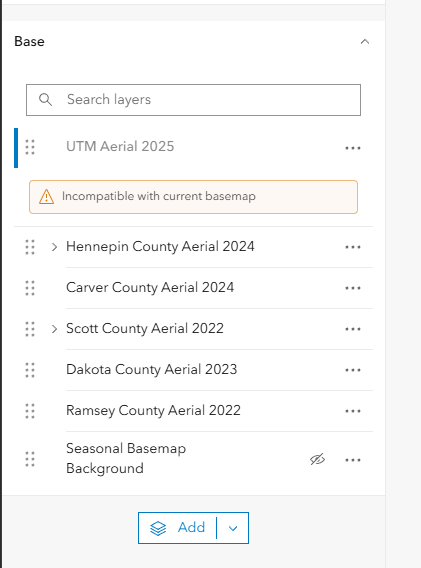

If you add the new one, and then move all the old ones out and then back into the basemap it appears to work
Also there is visibility range set on your new aerial you may need to update.
Amanda__Huber
MVP Regular Contributor
Hi @Neal_t_k ,
Thanks for your help! I just tried that and unfortunately I'm still seeing that error. I tried your workflow of adding it first, moving all items from basemap, then back in= error
Then tried adding the layer after removing items from the basemap = error
You were able to get this workflow to work?
Thanks again!
Amanda Huber
Neal_t_k
@Amanda__Huber Yes, Let me try to replicate what I did.
Neal_t_k
@Amanda__Huber Try adding it as a layer and then moving it to the basemap
Amanda__Huber
...WILD.
That seemed to work perfectly. You are amazing, thank you sooo much!
So next question, why would that be a limitation by Esri?
Neal_t_k
Not sure on that front, I thought maybe visibility thing, but that isn't it...
