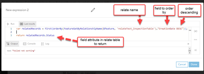

You can calculate a field in your feature class based on the value in a related table.
One technique is to the set a value based on the most current related record.  This is an example of an Arcade pattern that can be used to do that.
var relatedRecords = First(orderBy(FeatureSetByRelationshipName($feature, 'relateTest_inspectionTable'),"CreationDate DESC"));
return relatedRecords.Status
