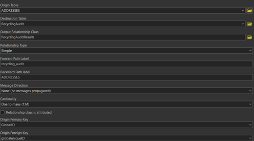

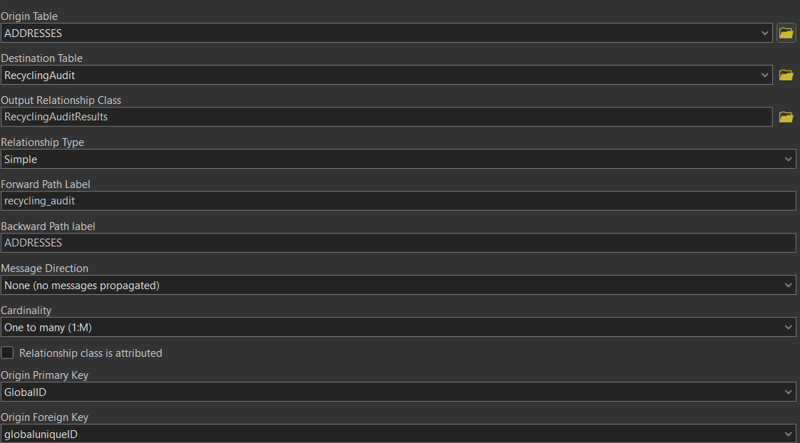

In ArcGIS Online, I am trying to create a Joined View Layer (with admin privileges) from a point feature layer and table that have a one-to-many relationship class which was created in ArcGIS Pro using a GlobalID and GUID field (I used the Inspection Workflows video as reference). Once created, I published the layer and table to AGOL.
In the screenshot below is my relationship class structure.

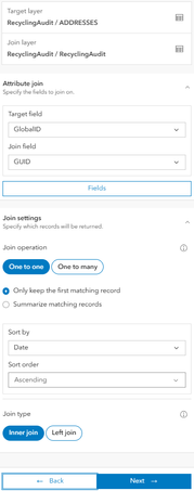

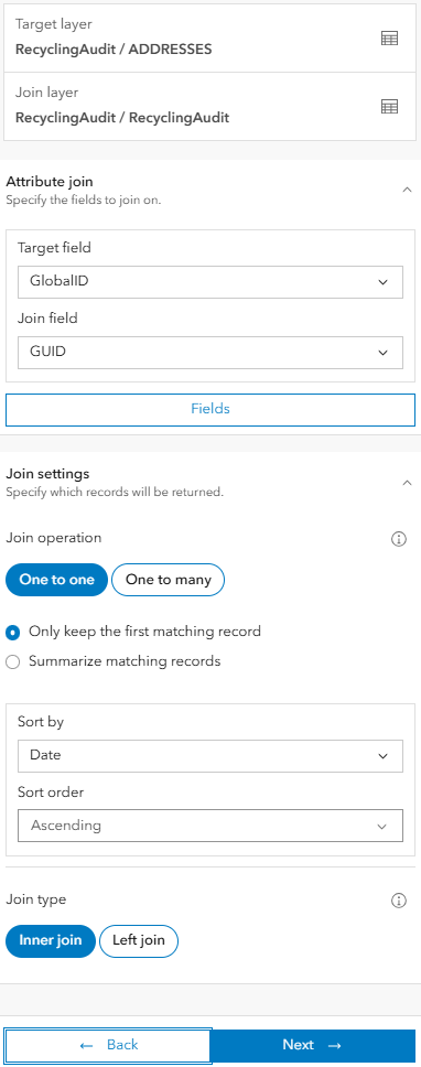

However, when I create a Joined View Layer using the parameters in the screenshot below, I cannot see the records that I created in the related table on the Map, as they should be represented as points. However, when I open the attribute table I can see those test records, but when I try to zoom-to nothing happens.
I have done this exact process in the past with no issues (using a GlobalID and GUID). I have tried republishing, updating extents, creating indexes for the GUID, and tried the Join Features tool in Mapviewer and Mapviewer Classic with no success.
