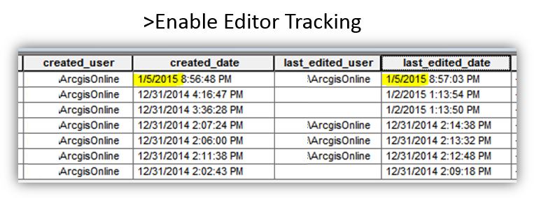

Mary Ellen:
I am using feature services from our ArcGIS for Server in AGOL and am seeing accurate date/time stamping of feature creation/edits (with UTC for the time).  These are the attributes from Enable Editor Tracking. Tracking.JPG
