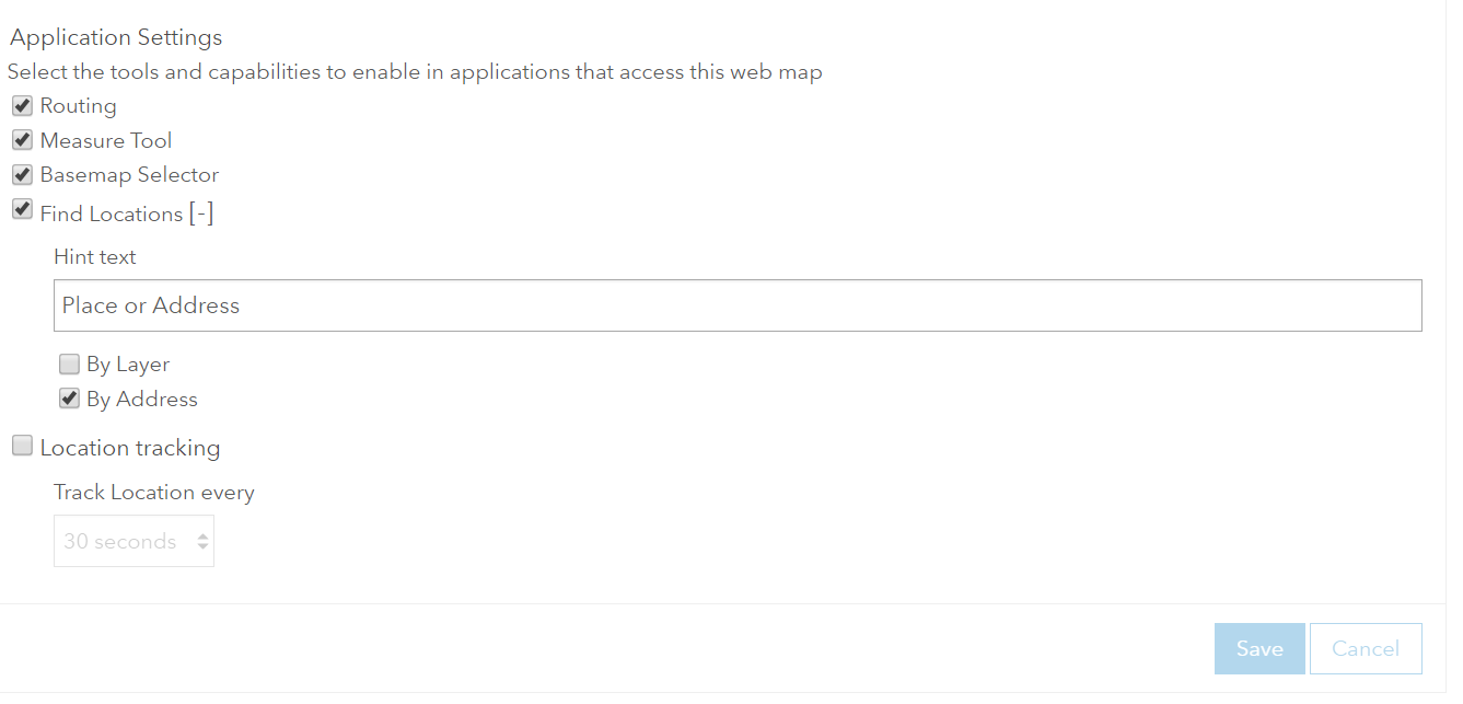

For whatever reason on the Settings tab, the Application Settings under the Web Map Settings section doesn't show an option to enable the Location tracking feature. Does this mean location tracking is enabled by default?
deleted-user-rqN42KX6-Rcs
Deactivated User
These are my only options:

That is the exact route I took to create the location tracking layer, yet my Web Map Application Settings did not show the Location tracking check box option. I think from this point I'll delete my current feature layer and create a new one to see if that helps. Thanks.
