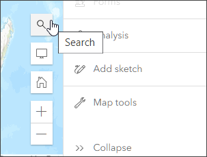

My original reply was over a year ago when we did have Search within the Map Tools, but things change (sometimes quickly) over time... The Search tool has since been moved out of the map tools and you should see it above zoom in/out, home, and hide interface:
As for ArcGIS Field Maps, as I sign in to Field Maps and view the list of maps that I have access to, I can see the Search at the top.
Unless I am misunderstanding your issue, everything seems to be working as expected.
