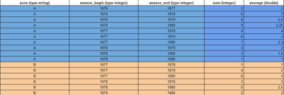

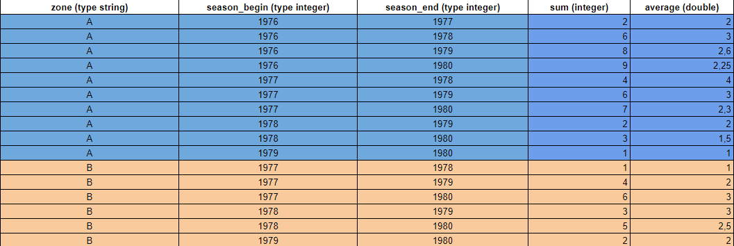

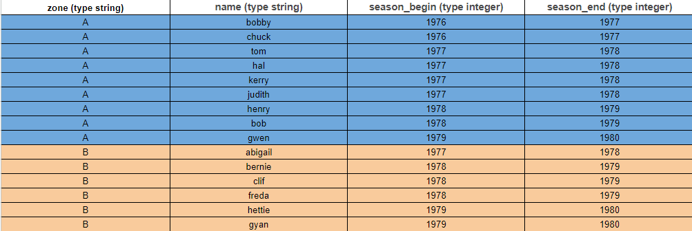

Hello,
I have a table with this structure.
As output i need a FeatureSet wich lists by zone all the possible combinations between "season_begin" and "season_end". Count the number of phenomena between these combinations and the average.
Can someone help me ?
jcarlson
MVP Alum
Honestly unsure how to get an average from a string field, but this will give you the count of phenomena per unique zone/begin/end combination.

Are the "phenomena" the name field? Or is that some other field not pictured?
- Josh Carlson
Kendall County GIS
explocarto
Yes the phenomena correspond to the name field.
kind regards
jcarlson
MVP Alum
