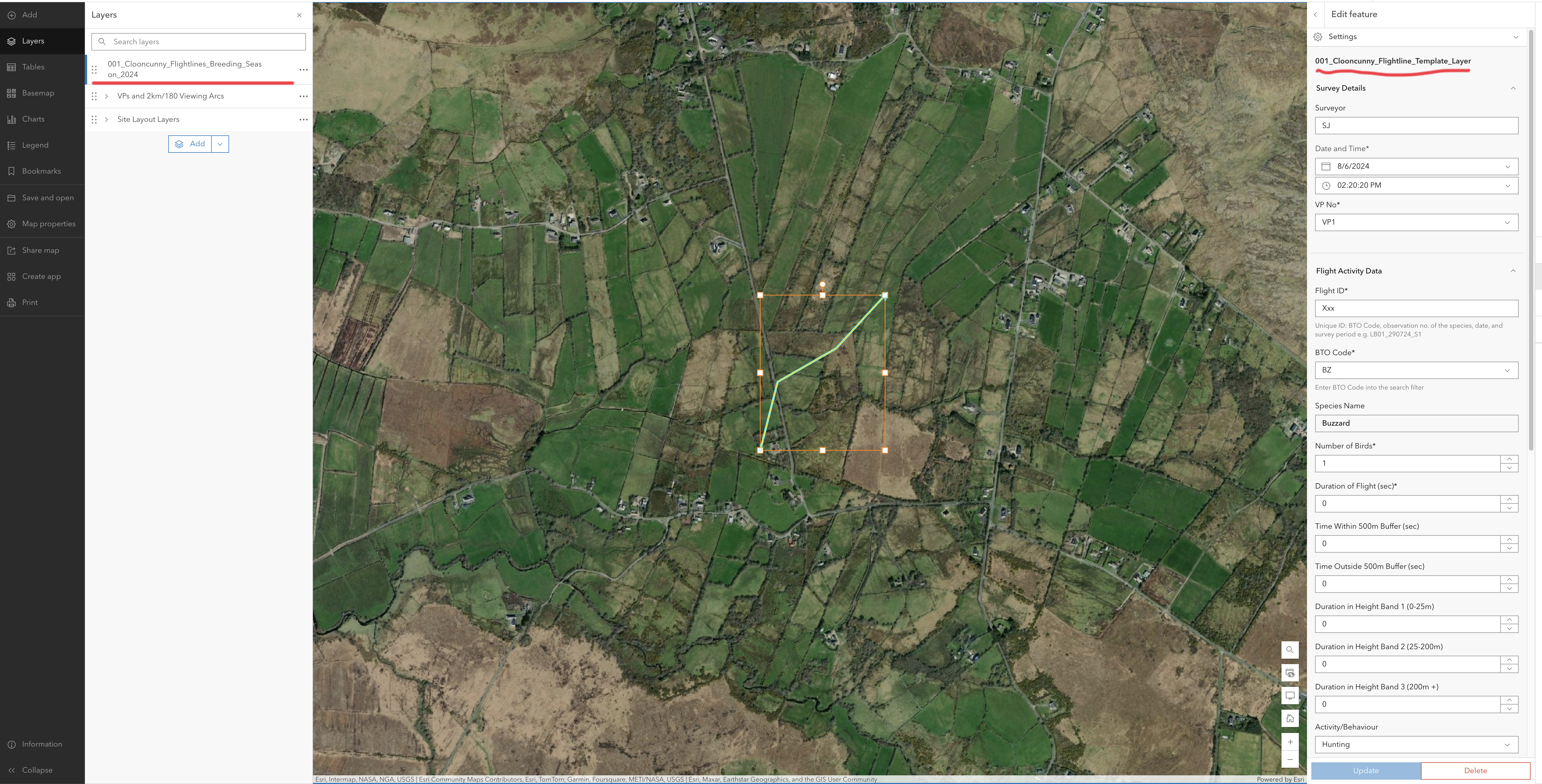

Hi there,
I'm testing a layer I have created to collect data in Field Maps. After creating the layer, I changed the title of the it to the one underlined in the layers list (left-hand side of the AGOL screenshot below i.e 001_Clooncunny_Flightline_Data_Breeding_Season_2024). However, for some reason, when editing the layer, it appears to be reverting to the original parent layer title (as shown in the Edit Feature pane on the right-hand side of the AGOL screenshot below i.e 001_Clooncunny_Flightline_Template_Layer).

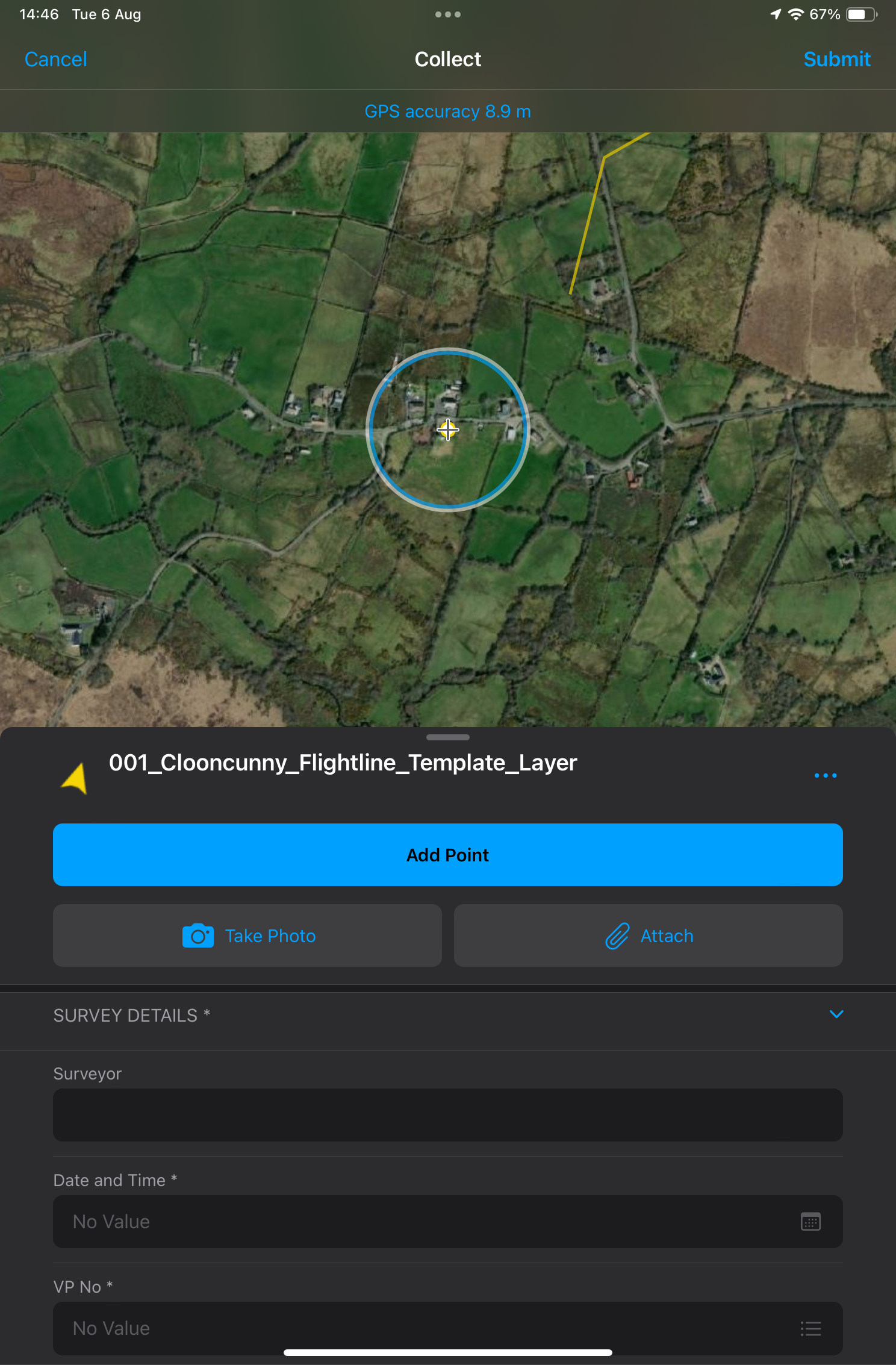

Also, when I open the layer in Field Maps (which is titled correctly in the FM layer list), it also opens as the parent layer title (see Field Maps screenshot below).

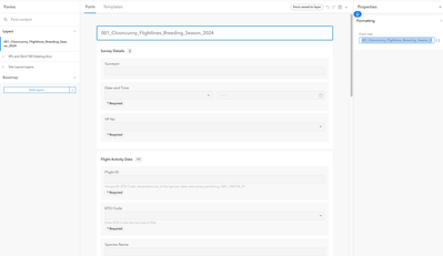

SarahJorgensen
Actually, I figured it out (for anyone else who may have this issue)! It's possible to simply edit the form title in Field Maps Designer as below:
