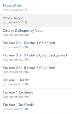

Here's another issue I just came upon today.
When viewing attribute expressions in the Map Viewer, the display order for expressions is now using text ordering and not numeric ordering.
In the example below, expression 10 is now next to expression 1.  This is super frustrating as many of the expressions built are in sequence while working, so now I have to scroll up and down when moving from expression 2 to 3 to 4, etc...
RussRoberts
Esri Notable Contributor
this was fixed in last nights patch and expressions should be displaying as you expected prior to the release.
