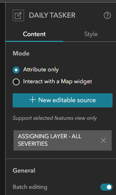

Another issue I found. And anyone with ExB apps might want to check into theirs too. I have several ExB apps that I have setup for users to make attribute edits on specific layers. And often times I have it set for batch editing so they can edit the attributes of several points or lines at a time.
How I want it:
But it looks as if this June AGOL update has reset all my editing widgets in all my ExB apps from "Attribute only" to "interact with a Map widget"
So essentially it broke the ability for my users to do quick attribute updates on several features at a time.

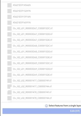

And it also now selects every single layer in the map with the editing-selecting tool. It would even select layers not turned on! And it would even select the .tif raster files of the imagery layer in the map - and even if the imagery was turned off!
So because it now selects dozens of unwanted features that are not editable, the 'Edit' button is greyed out because it thinks I'm asking to Edit those features.
