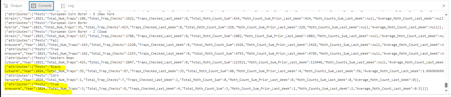

I created an arcade expression that takes a feature service and calculates some stats and outputs the results into a FeatureSet.

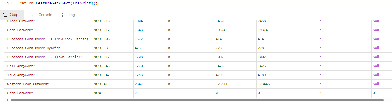

The problem that I run into is some of my Dict is not writing to my FeatureSet.  When using the Console I can see that everything has written properly to my dictionary but seems to be missing from the FeatureSet.
I highlighted the two rows that are missing.

And the value (CEW) for 2024 that is included falls between the two that are missing... alphabetically (BCW, CEW, TAW).
Any help would be greatly appreciated.

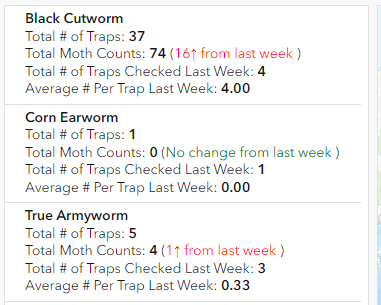

Well... I think I answered my own question.  The issue was around the Date SQL.  I was doing my Date calculations from my service as opposed to using a new Date variable Today().
var dt_7 = DateAdd(Date(Max(Trap_Locations_Tab, 'Trap_Check_Date')), -7, 'days')
As opposed to...
var dt = Today()
var dt_7 = DateAdd(dt, -7, 'days')
I need this change detection for my dashboard.
