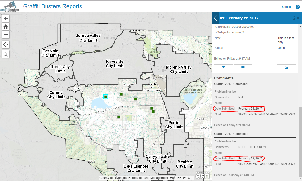

I'm a little confused of all the automatic data fields that got created from the Crowdsource Reporter geodatabase template.  I'm using the desktop version of Crowdsource Reporter geodatabase with comment and photo related tables.
I added two comments on different dates under the application.
It also shown correctly on the webmap table.  But I don't understand what are the 3 dates on the pop-up window supposed to be.  Since there are 2 comments, do the date fields reflected on the latest one?

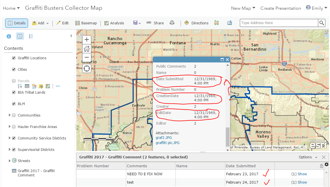

Hi Allison.  Thank you for your reply.  Sorry, I should have stated my question better.  I meant the editor tracking day/month/year are incorrect.
AllisonMuise1
Deactivated User
I see what you mean, now, and that is very strange...
Could you contact support about this? Unless you've got a time machine, editor tracking fields shouldn't have dates from '69!
