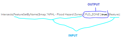

RyanBohan
Thank you @jcarlson your explanation makes sense.  You are correct it is much faster when the geometry is excluded.
I was getting the input and output confused.  The query do the intersection, and the part in blue is the  results.  As my arcade as no further need for the geometry no reason to return it, so False would be quicker.
Thank you!  I think I get it now
