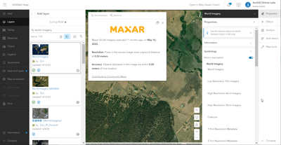

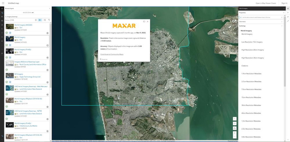

I just realized that blog covered Map Viewer Classic. To view the metadata in Map Viewer, just add the World Imagery layer from Living Atlas, then click on the map after zooming to and in to your area of interest (metadata is scale-dependent).
SteveCole
Honored Contributor
I just opened a blank AGOL map, searched AGOL for the Imagery basemap & added it to my map and clicked on the map..
BernSzukalski
Esri Frequent Contributor
Yes, that's the way to do it. Zoom in or out, or pan to different locations and you'll see differences in the metadata.
