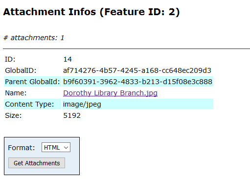

You can drill down in the REST URL for the attachment URL.  For example:
https://services.arcgis.com/dlFJXQQtlWFB4qUk/ArcGIS/rest/services/PropertyDamage/FeatureServer/0/2
Where the /2 is the OBJECTID.  This will give you a page like the following:
The attachment ID is 14, so the attachment URL would be:
https://services.arcgis.com/dlFJXQQtlWFB4qUk/ArcGIS/rest/services/PropertyDamage/FeatureServer/0/2/attachments/14
