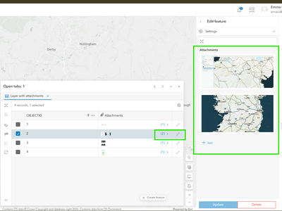

If you are looking to add an image from attachments:
Here you can see I have added 2 attachments to my record.

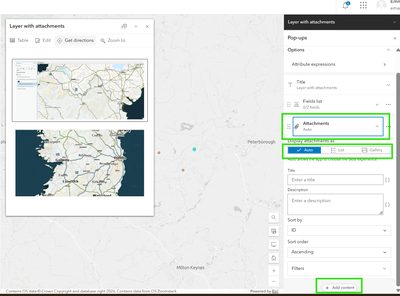

Here, I have added an attachment viewer using +Add Content in the pop-up.
This way shows multiple images at a time in the pop-up.

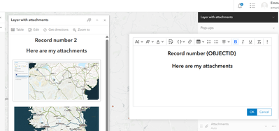

You can add text and other content types to the pop-up along with your attachments.

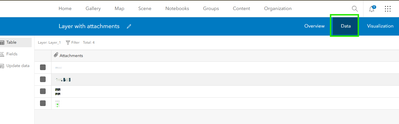

You should see the attachments in the table when you look at the data view of your layer.

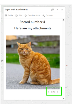

If you are looking to add a hosted image from a URL:
You would add a field {Link1} in your table and add links to each record as text "https://yoursite.com/your-image123"
You can add as many fields as you have images. So if you want 3 images per record, add 3 fields {Link1} {Link2} {Link3}
Then add an image content type to the pop-up using +Add Content.
In the URL field click the {} and add your field.
Then add another image content block for Link 2 and another for Link 3.
This way shows only one image at a time in the pop-up.

Yes, both of the above workflows work for multiple images for each point. The first one shows all of the images relating to one point in the same pop-up, where the user scrolls down to see the next.
The second one, with the cat, the user scrolls through the images left to right using the arrows.
You will need to decide a maximum allowed number of images, to have a field for each one.
