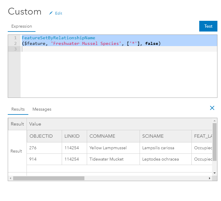

Hello,
I am trying to display related table information in my popups within my webmap. I have a layer and its associated related table within my layer list. I set up the Arcade function (FeatureSetByRelationshipName) within the custom attribute expression following the documentation online. When testing the function it seems to work as it should but when I click the popup within the map I get no information. How can I display my feature layer and related table information within the popup?

Hi David Krady ,
The test result shows that you are receiving a featureset. A featureset however, cannot be visualized in a pop-up, that is why you won't see the information. You need to extract the relevant information from the featureset and return that as a (multiline) string or value.

Hi David Krady ,
Currently there is no support for returning a featureset, as you noticed. You will have to gather the information of each related feature and each field and this might make the expression a bit long and the visualization is limited since you cannot return HTML (yet).
