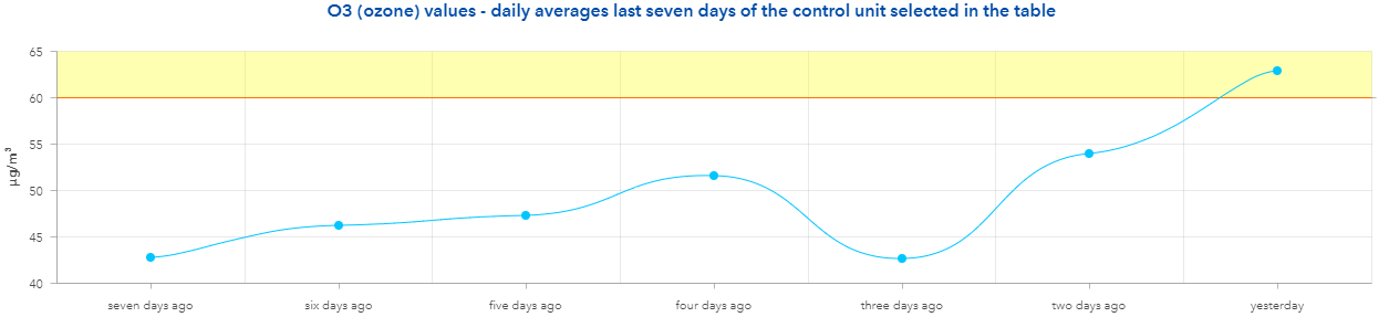

I have a chart in the dashboard linked to daily Ozone data.
The data is updated via REST API on a feature layer hosted in AGOL.
The chart on the dashboard is linked to that feature layer.
Well that's great.
The problem is that when I made the chart I inserted some labels that remain fixed and I don't know how to change them so that they display the real day to which they refer!
I was forced to use generic labels, like "one day ago, two days ago, etc.). But it's not exactly the best.

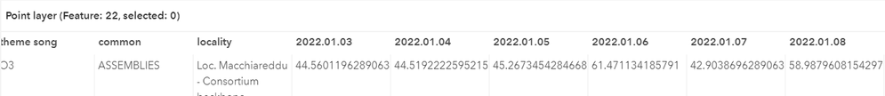

Fab_the_lab
hi Josh
yes,
actually I am able to dynamically change the name of the fields in the hosted feature layer. So the answer is yes, the date is stored in the feature layer.
(see the screenshot)
