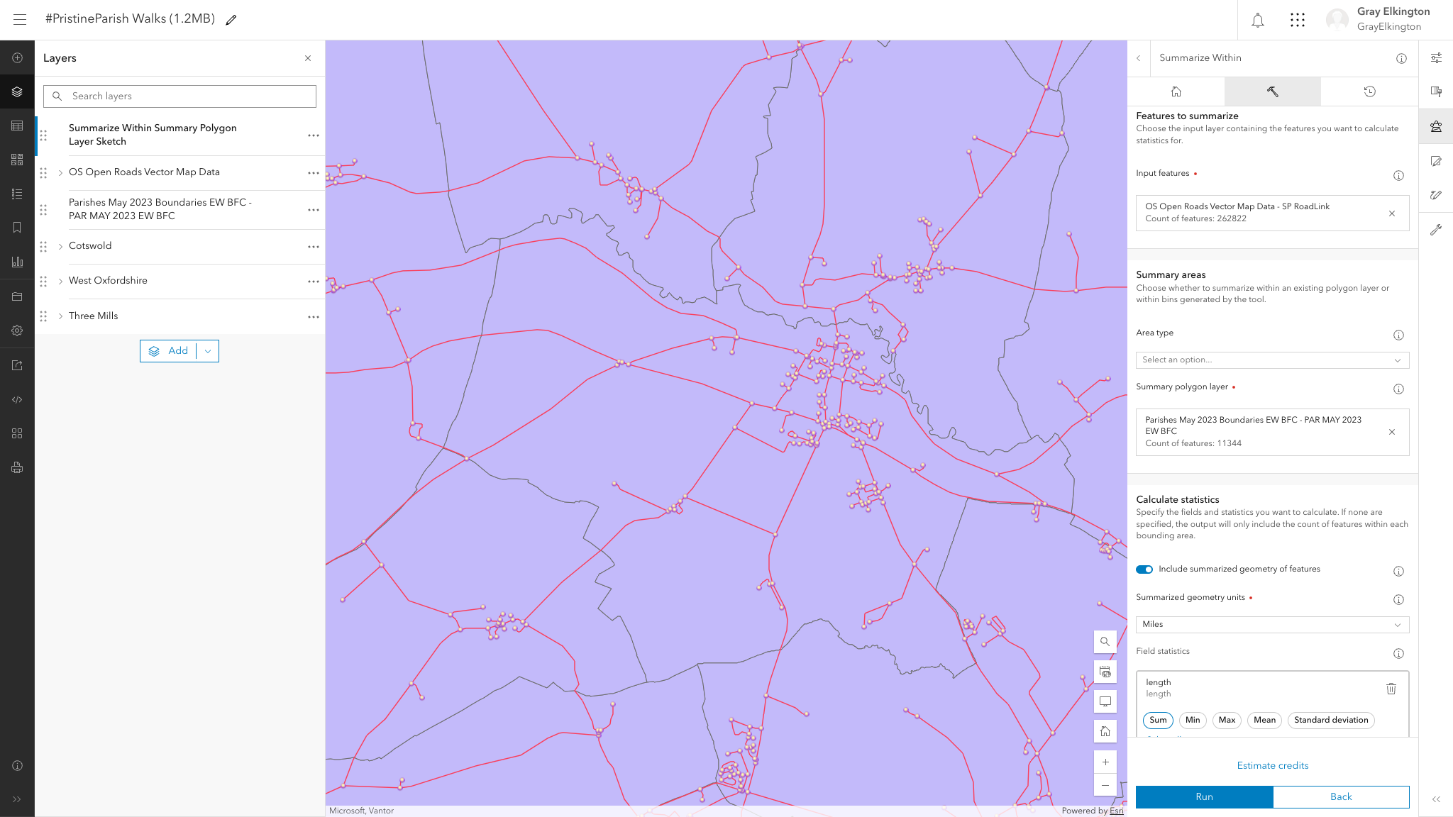

I'd like to to summarise the road lengths within the parish of Burford.
I'm logged into ArcGIS Online's Map Viewer and using the Summarize Within tool:
  1. Features to summarize: OS Open Roads Vector Map Data - SP RoadLink (Burford is within the SP Area)
  2. Summary areas: Parishes May 2023 Boundaries EW BFC - PAR MAY 2023 EW BFC (Covers England & Wales)
  3. Calculate statistics:
    Summarized geometry units - Miles
    Field statistics - length > Sum
  4. Environment settings:
    Processing extent - Full extent
Obviously, this gives me results for the entire SP area. The other Environment settings are also not what I want.
So, how do I clip the features within Burford to Burford's boundaries?
After 48 hours of trying and failing, any help greatly appreciated!

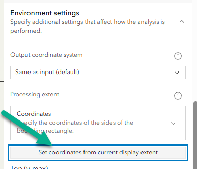

BobBooth1
Try setting the Analysis Extent to the current display extent, and zoom to the extent of the parish.
https://doc.arcgis.com/en/arcgis-online/analyze/environment-settings-mv.htm
See this bit of a tutorial for a model of how to set the extent:
https://learn.arcgis.com/en/projects/clip-a-layer-in-map-viewer/#:~:text=extent%20of%20the%20map%20t...

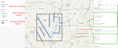

Hi @GrayElkington you can either "clip" the features using the overlay layers tool (union option) or put a filter on the polygon features.
Option 1: Use the Overlay tool
  1. Add the line layer and polygon layer to the map

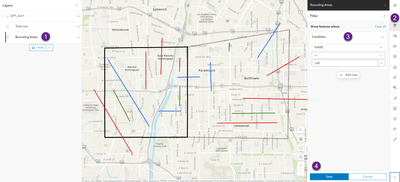

  2. Create a filter on the polygon layer (I'm assuming your Parishes Boundaries layer has a field you can filter on). Something like "Area == Burford". See screenshot on filtering below.
  3. Run Overlay Layers -> Intersects with the lines and filtered polygons. Make sure the output geometry is set to "Line"
  4. This should result in the lines that are within the Burford Area.

I think those should both work. Here is what setting a filter looks like:
  1. Select the layer you want to filter
  2. Click the filter button
  3. Set the condition to specify the features of interest
  4. Save it
Once you save it, you will only see the filtered features on the map.

GrayElkington
Thank you Bob and Sarah.
Bob, if I set to the current display extent the borders won't exactly match the parish borders. So, if I understand you correctly, that won't work since I need the lines intersected at the parish border.
One of your links points to the Overlay Option. I recall, two or three years ago, managing what I'm trying to do by only using the 'Summarize within' option, so I'm tempted to stick with it. I should have recorded how I did it, but hindsight...
Sarah, thank you... I favour 'Summarize within' but can't get the right result.
Could you please check my workings below:
In the Layers Menu, I select the Parish Boundary Layer (PBL) (i.e., Parishes May 2023 Boundaries EW BFC - PAR MAY 2023 EW BFC).
With the PBL Layer still selected, I click on Filter in the light menu and enter the code for Burford, which is in the table that appears by clicking on Burford in the map, i.e., labeled PAR23CD.
I click on Analysis in the light menu
Under Tools, I select Summarize within
My selections are then:
Input features: SP RoadLink Layer from Layer Dropdown
Summary Areas
Area type > Polygon layer: Parish Boundary Layer (Count of features: 1)
Include summarized geometry of features: Toggle ON (to total the Length of all Lines)
Summarized geometry units: Miles
Field statistics: Leave
Group by field: Leave
Result Layer
Output name: Burford Roads
Save in folder: GrayElkington
Output coordinate system: WHAT DO I PUT HERE? (putting the PBL costs 262 credits)
Processing extent > Layer: WHAT DO I PUT HERE? (putting the PBL costs 262 credits)
BobBooth1
Hi Gray,
My suggestion to set the processing extent to the display is intended to limit the number of input features considered in the overlay analysis. It should affect the credit consumption but not the shape/values of the results of overlaying the parishes and the roads (provided the intended analysis area is contained within the display extent). With the parishes filtered to Burfurd and doing an analysis of the roads within the current extent that fall within Burfurd, the credit cost should be well below the 262 figure you're seeing.
Best,
Bob

I agree with @BobBooth1.
1. It sounds like you have correctly filtered your polygon layer, great! Remaining decisions are mostly about excluding features in your lines layer to lower the number of credits consumed.
2. For the environment settings you have a few viable options:
  • Processing extent: You have a few options:
    • Layer - This will use the extent defined on the layer (even if you have a filter, it's pulling it from the original layer), and isn't filtering down the features. This will produce the same result as below, but will cost more credits than if you exclude some features for analysis (via other env settings).
    • Display extent - this will help help cut down on credit consumption. Note that it won't "clip" the input features, it will use anything that intersects with your display extent. I would recommend using this option, and make sure when you run the analysis you are "viewing" the area of interest. If you don't want think about what's covered in the extent when you run the data, you can choose "Coordinates" and then "Set coordinated from display" - this will set the extent when you click the button, and won't change even if you zoom or pan around before clicking run. SarahAmbrose_0-1763389153473.png
  • Output coordinate system - I would keep it as the default unless you know your result should be in a different coordinate system than the inputs.

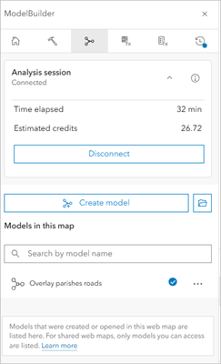

BobBooth1
Given the number of parishes, I think a different approach is warranted.
It looks as though there are around 1,280 parishes that cover the SP_Roadlink block of road segments.
I tried the analysis using the Summarize Within tool in ModelBuilder in ArcGIS Online.
The process ran for about 30 minutes (less actually, but I wasn't watching when it finished) and the ModelBuilder session cost 26 credits. You pay for Analysis Session time rather than features processed (mostly) when using ModelBuilder in ArcGIS Online.
The awkward thing is, you said 14,000 parishes. The way the road data is tiled, you'll need to run the analysis on each block of road segments (so, roughly 30 times?).
