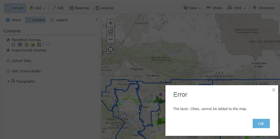

Hello GeoNet,
It might be an easy question, but I can't seem to find the answer for it... I have this map service (Cities) that is currently not available, but I don't know how to remove it because it's not visible on the webmap.  If I just click OK, the error message would come out every time I load the webapp.  Is there a back-end way to remove the layer altogether?  So, I don't need to rebuild another webmap without the unavailable layer?
Thank you!
Emily

After opening the web map, save it again. Open the web map again.
Does the issue persist?

EmilyLee2
Wow, just like that?!  Thank you, Jayanta!! 😃  You're right. The unavailable layer is no longer in the layer list under the webmap's detail page.  😃  Thank you!
