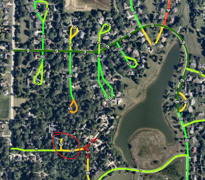

I have labels that are numbers in a web map.
How can I make these labels not have rotation? The 6 and 9s can be confusing to distinguish.

I don't think there is a native way in AGOL. For lines it seems to follow the geometry. You could create a point layer that is used for labels that way they are all up and down.
I face the same issue in my water main layer.

JamesPoeschel
That's a good work around, thanks.
