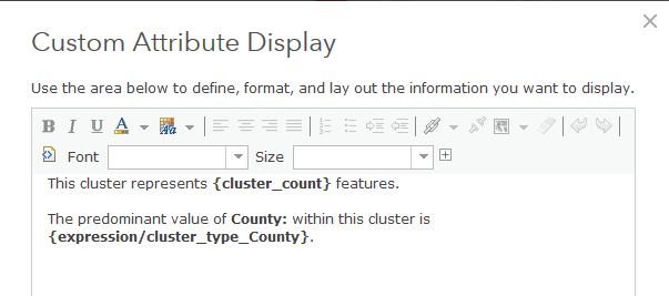

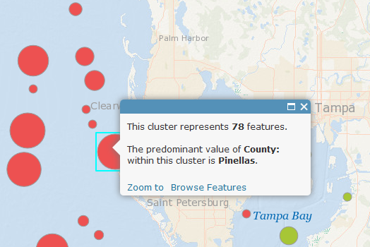

In the recent ArcGIS Online update the ability to cluster points was added. There is also a new cluster pop-up that includes a default 'predominate value' expression. Since i don't have a lot of experience with Arcade I am looking for some help to create similar Arcade expressions for other fields. In the screenshot below you can see that the default expression is the predominate [County] of the clustered points. I would like it to show the predominate [Name] of the clustered points. Since these are string variables I'm not sure how to get this value in Arcade. It doesn't appear that you can edit the default expression. I am guessing if this functionality is even possible, I would have to create it in the attribute expressions window. Any ideas?
Edit: I just wanted to add that after some research it looks like the 'predominate value' is based upon the field the features are symbolized by (in my case by [county]). From what I have tried so far it looks like the ability to add more fields/expressions to the cluster pop-up isn't possible. I could re-symbolize by the [name] field and that would cause the default expression to change. I however would like to keep the features symbolized by county so this doesn't solve my problem. Essentially I have a feeling this ability is not possible in this version of AGO.
